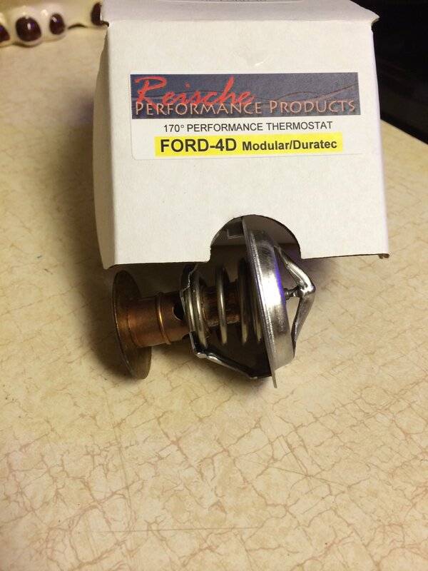

Sounds like you may not have the proper thermostat. The Mark VIII runs a bypass thermostat housing which allows coolant circulation to short circuit the radiator until the thermostat opens which then closes off the bypass between the coolant crossover and the t-stat housing.
The improper t-stat does not close off the bypass which effectively reduces flow through the radiator and results in overheating.
170° PERFORMANCE THERMOSTAT for Mustang Cobra, Mach 1, Mercury Marauder & Taurus SHO by Reische Performance Products
Proper fill/burp procedure(link).

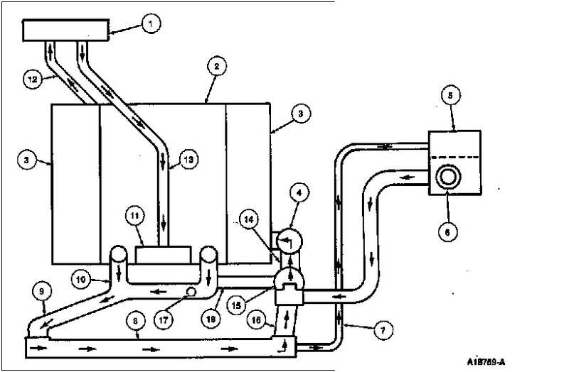

Thanks, driller. That coolant flow diagram is especially helpful--I had the flow pattern all wrong in my head.
On that diagram, hot coolant should be flowing from 18 to 15, thus opening up the thermostat, correct? What's confusing to me is that after 20-25 minutes of idling, my temp readings at around points 9 and 15 (ends of both of the hoses coming from the crossover) are about 50-60 degrees different (cooler at thermostat side). Shouldn't those temps be closer? Could I have a blockage somewhere?
During warmup, yes coolant should flow from 18 to 15 and the radiator is dead headed at 16. As the thermostat opens, coolant flows through the radiator and the bypass closes off at 15. The wrong t-stat will not close off the bypass and subsequently short circuits the flow through the radiator. In effect it's practically the same as no thermostat.
As far as temperatures, it would be normal for the inlet to the radiator to be hotter than the outlet to the thermostat. It's been a while since I scanned one with an IR thermometer but I would say 20-30 degrees easily, certainly more under load. Higher than that would have me believing there could be a flow restriction in the radiator. That would also fit the symptom of water pump failure (from excess operating pressure?).
