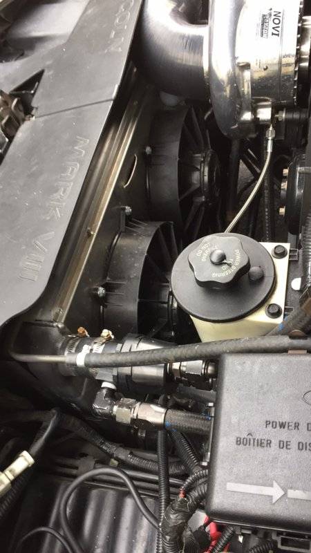

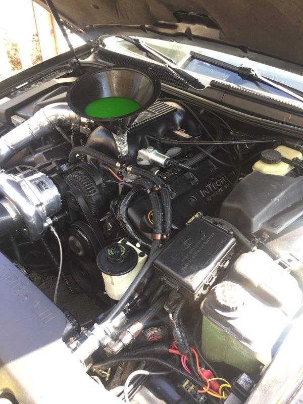

    3D4E0ECC-EA01-40DC-8601-DD75B0863C50.jpeg D6B00B4B-31FD-48D9-A573-27964645A4CC.jpeg I have done it as well as the head cooling mod. I used the ON3 performance kit. To do it again...
    Go to eBay and search 4.6 HCM or crossover delete and you should get the fittings that go in the heads for $30 a piece or so. Not when you get your AN fittings to get one that can accommodate your coolant temp sensor/switches to screw in the side.
    From there get the inline stat of your choice. I used ON3. It has a port on the side for the head cooling mod.
    The HCM you can use the same
    Fitting as you got for the front.
    Also note the fittings will be 3/8” pipe I believe. Will need to get the proper sized AN fitting adapters and hose. Mine were -10.
    After I did this it ran cool as a fool. Later I changed some stuff and thought I had air trapped so I added a T fitting on top to bleed the air out. Didn’t change anything.
    Also note my radiator is different so you will have to interpret that a little differently as well.
