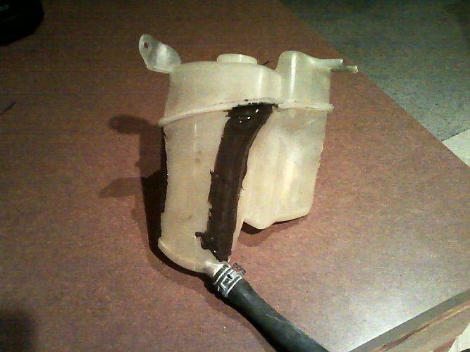

Well, a posted a while ago about my car over heating on the highway and then mysteriously would go back to normal in less than 5 minutes. I checked and checked for leaks but never found anything.
For the last week or so I started seeing dripping under the car where the tank is, nothing fast, but would have to put a bit of water in every other day. However, today I get home from work and there is a small stream of water dripping at a high rate from the coolant tank area. So I pull the tank off and find a couple hairline cracks along the edge. I scuffed the whole area really well with a rotary wire brush and then used the JB Weld.
So far so good, but it probably won't hold long with the heat and pressure, but it is worth a shot. Guess I'll be online with RockAuto soon.

So the problem will be the tank expands and contracts - albeit just a tiny bit. But any movement will break the JB Weld off, because it's not flexible.
But, hey, if it holds for a week until you get the part, then that's better than not having a car!

Well......the patch lasted approximately 104.9 miles and that is about 6 heating and cooling cycles. Oh well, as we figured it didn't hold. :rolleyes:

All you would have to do is rough it up a bit. then the silicone would expand and contract with the crack.
