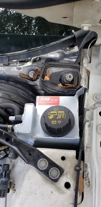

    Have you considered the aluminum degas tank?
    • Agree Agree x 1

      I can't see how it would work for more than a day or three. The tank pressurizes and de-pressurizes over and over. Each time it flexes out and then back in. I think that would pop the epoxy off in short order.
      What about this?
      https://www.amazon.com/gp/product/B01EIUMWL2/ref=ppx_yo_dt_b_asin_title_o09_s00?ie=UTF8&psc=1
      Can you get that in Canada at a reasonable price? It's $65 in the US.

        Just to update:
        We pulled out the bottle. It was swelled up, and bursted open. Looked like a knife was plunged through it. Impossible to seal as well do to the material type as Robert Crain pointed out.
        I have found one on amazon for $79.99 and ordered it. I was tempted to order the aluminum one off ebay, would cost $180 with shipping, but coming from china and its taking 3+ months for stuff to get here from china right now.
        Thanks for advice and tips.

          If you order the aluminum NOW it will be at your house just in time for when the new Plastic one bust open again ...lol...J/K ...maybe
