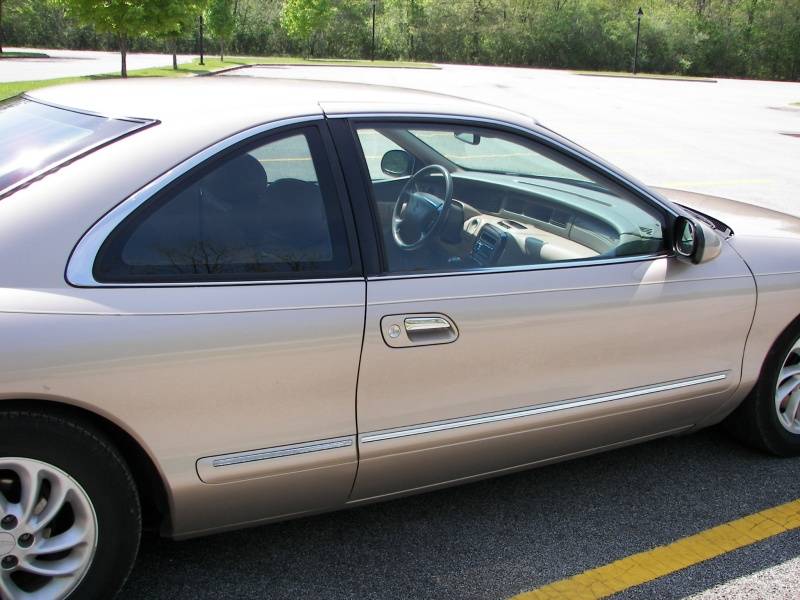

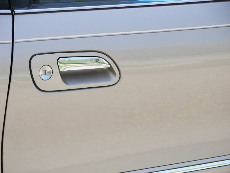

My 97 with chrome Conti handles....no modifications necessary.
Wow, that looks better than I thought. And since I have the same color it just made up my mind. What year are the handles from?
