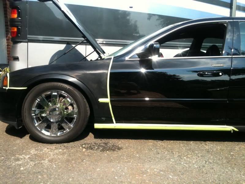

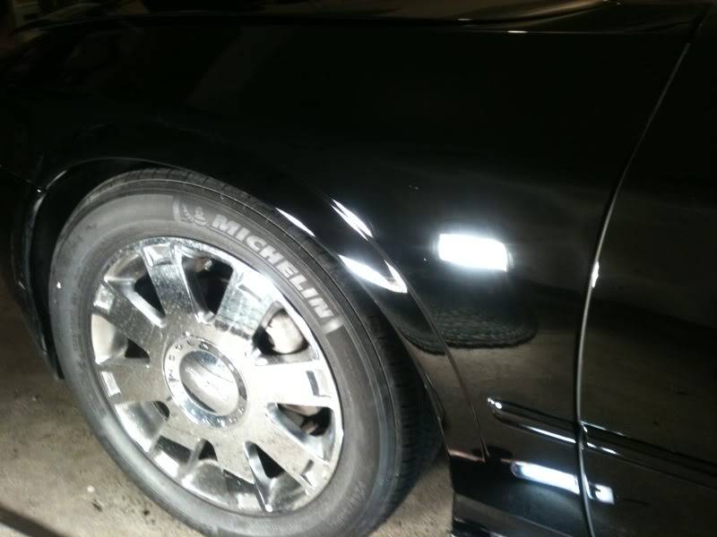

Decided to remove the orange peel from the Lincoln. The op on the LS is not nearly as bad as the other Fords I have owned but I cant stand any. I started about a week ago, working a few hours a day when I can with maybe 26 hours total so far. I have the quarter and 2 drivers side doors complete (still need to be jeweled, wax and sealed but that will all happen to the whole car at once). Driver's fender is sanded but not polished, so the drivers side is almost done.
Here is before the color sanding. Paint is pretty clear but the reflection is slightly distorted.

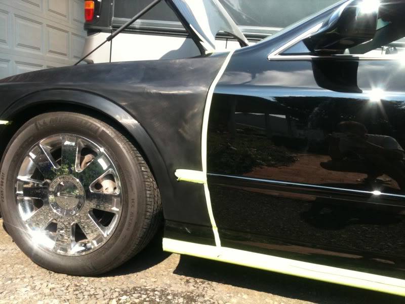

Fender sanded down, looks scary doesn't it?

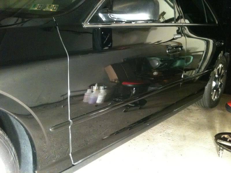

Door is nearly done, it will be a little deeper and darker when the final jeweling is done and then wax and sealed.
Crystal clear reflection when the clear is flat.
Just realized I dont have any pictures of the other door and quarter. Should be able to get some more hours in tomorrow and some better pictures. Hopefully I should be done in 2 more weeks, then I may drive it again.
I'm confused. I see the fender taped and sanded, but you're talking about the door?

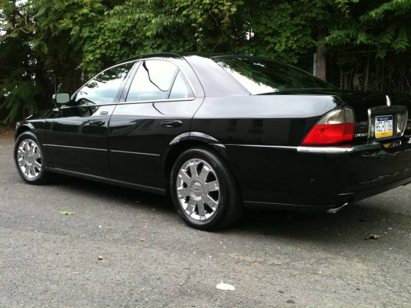

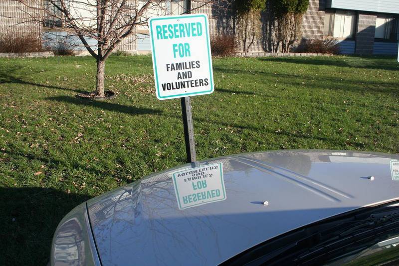

Here's a couple afters of when I did mine. I took it real easy on the door panels under the body moulding. ultra smooth paint + rocks = huge cracks in paint.
Can't remember which panel this was, but you can see the absence of OP:

Nice work! I want to buy a couple more pads, i'll give them a try and my souveran is almost gone. Was going to buy another can but if that supernatural is the around the same in cost, i'll give it a try. Good call on the sealant before nuba; i tend to only use nuba, all the sealants i have ever used streak on me or haze up and hour or so later. I wash and wax atleast one of my cars once a week so each is waxed atleast every other week, wax has always been quicker and easier but with the souveran at $100 a jar, I deal with klasse or 845 every once and a while to make the nuba last. I was able to get the fender polished up today.
The very bottom of the fender and doors have not been sanded, no way i'm going that low without a lift.
