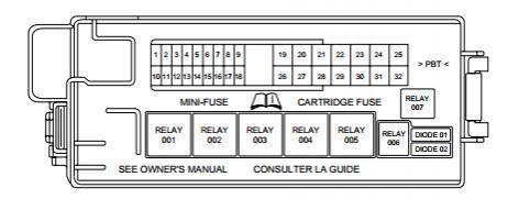

Check your fuel pump relay. I had a similar issue with my 95 Ranger. It's in the trunk. Relay number 7. I could tap on mine and it would start. If the other relays are the same, you may be able to switch to test it.
