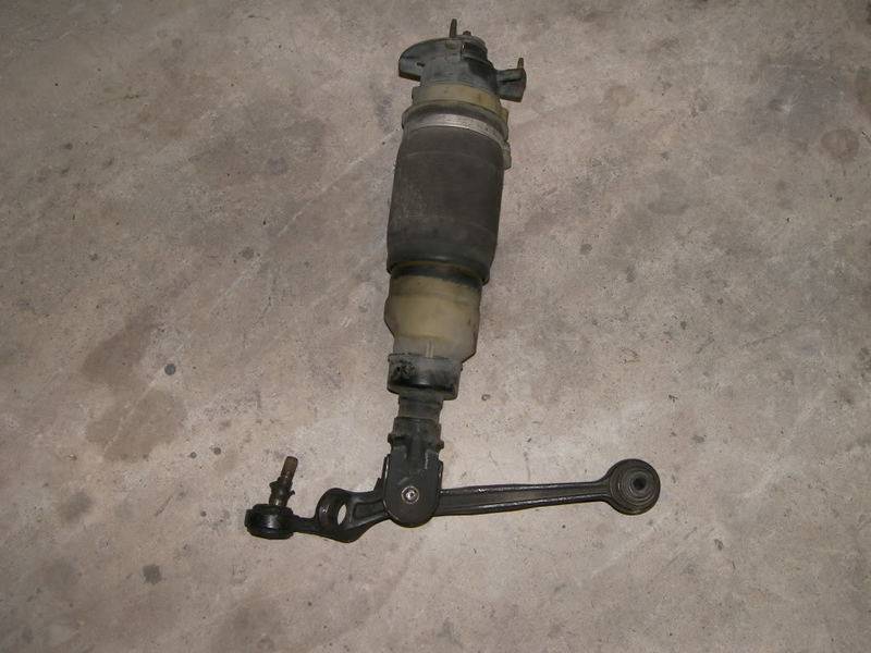

I had the very same problem on my Green LSC. I removed the whole assembly since I was changing everything any. The bolt holding the airbag to the LCA was seized.
