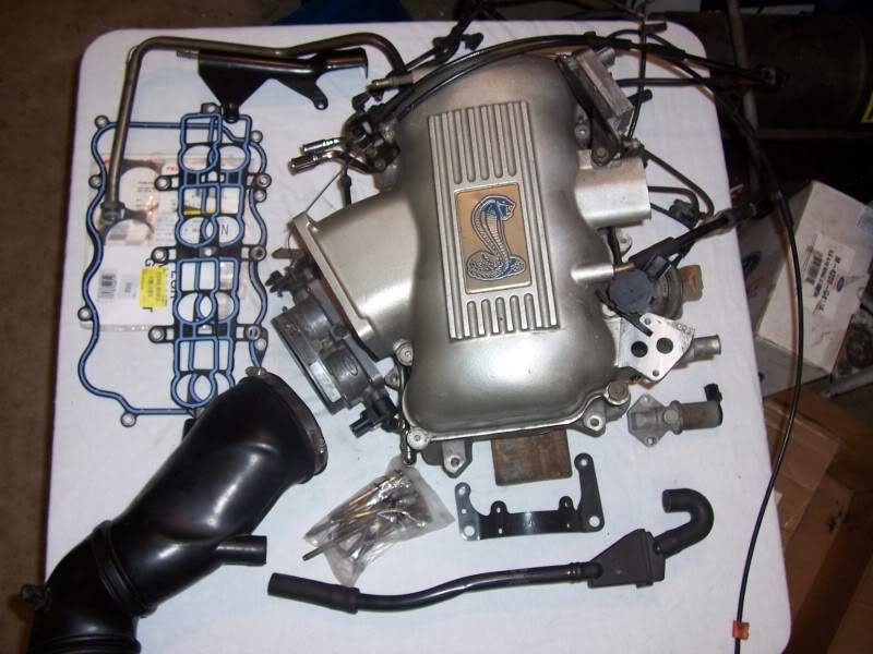

As well as many many other parts. Frank..show him the pic.
Here you go LOL If you have a Gen 2 you don't need all these parts. You will also need IMRC's if you have a gen 1.
