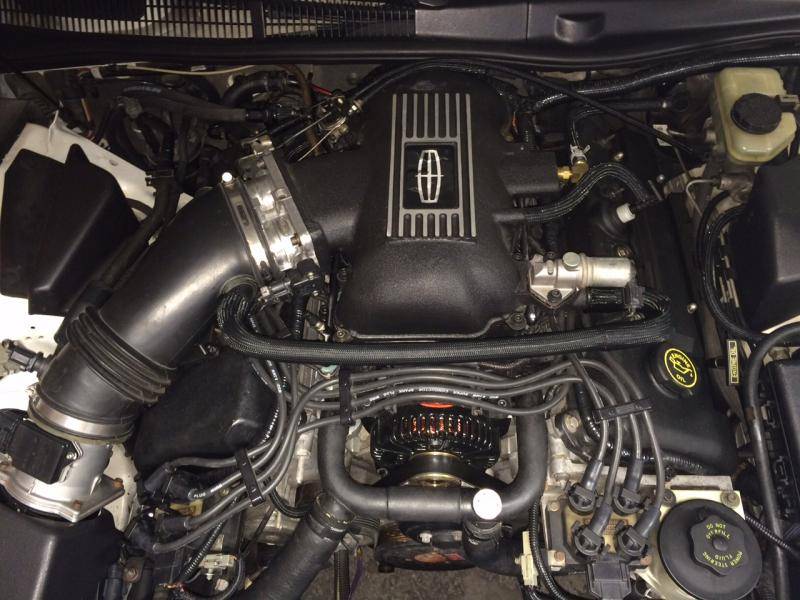

Mine isn't special but it works. It's a hybrid of a 5/8" heater hose with a 90 degree pre-formed end joined to a 3/4" 180 degree pre-formed heater hose using a brass 5/8" to 3/4" hose barb.
I covered the hose with a black hose sleeve solely for looks but the sleeve tends to crinkle somewhat in the bends.

Driller... NICE PICTURE!! Thanks a lot for the help! I take it you havent had a problem with the hose collapsing over time. I was a bit concerened about that. The molded heater hoses I have looked at seem to have a slimmer and thinner sidewall than the stuff I see cut from the bulk roll. I like your intake, is that black wrinkle paint or powdercoat? Did you do the same to the valve covers? Kinda hard to tell in the picture.

Stock heads, powder coated intake and wrinkle finish valve covers. Several details did not pan out as good as I would have liked but it was difficult finding all the hose and fittings to fit for function, let alone for looks. I may change a few things over time.
The hose wasn't that thin to worry about collapsing.
