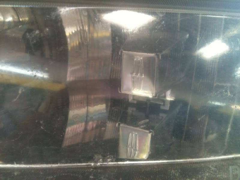

Guys... the INSIDE. The side that faces the bulb. Not the outside that you can see through the lens - those are indeed all chrome.
i think your the only one who caught on, maybe jaime did, the part sap showed off with the lincoln emblem on it, what should the inside of that housing look like?
the refractors like sapp's are chrome, only in the hid lenses. terry has brand new housings in his mark, stock halogens, if he feels like it he could take one out of the car and take a pic inside the low beam bulb hole, the inside of the refractor in a stock halogen bulb was black, not chrome, only the hid refractors were chrome. inside and out.
dont touch the inside with anything but chamois. i put apost awhile back when i changed lenses, sprayed a cloth with windex and it stripped the chrome instantly.
