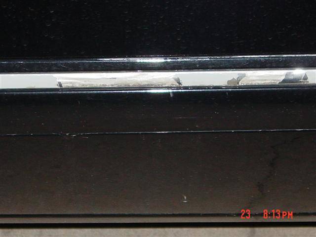

Does anyone know the best way to do this? Ac you can see by the pic, My chrome door trim is toast. I have a roll of chrome trim tape on the way - whats the best way to prep the surface?
you have you pick the rest off, which is hard. then clean it up real good
I got the tape in today -- Maybe ill try and install it on friday........ Im thinking about trying to powerwash the rest of that stuff off.........

i have tried a few thing to fix that the best thing i have found is to go to a good paint store and buy some chrome molding i used 5/8" and trimed it down to size. after you remove the old one clean out all the :q:q:q:q in the groove . and lay in the new piece . if done right you can't tell the difference .
