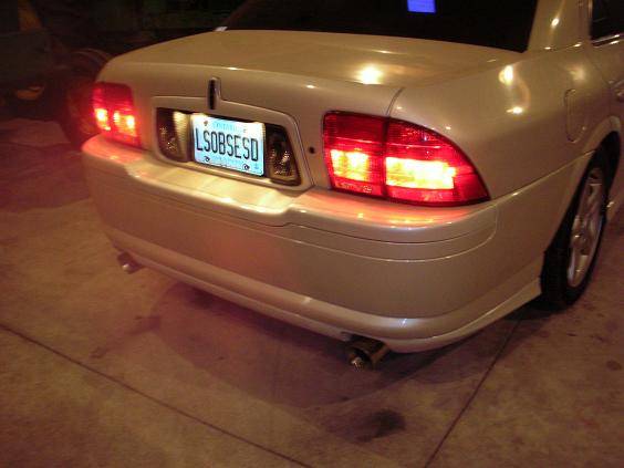

here is mine
:lol:
Not to start another fight with you slick but it looks way different even color matched than a sport. Lets also not forget the shot is taken at night;)
I can definitely see the trim piece. Dude the sport doesn't have anything at all. Its totally void of that trim piece and smooth. If it were identical it would have that trim piece and it would be color matched from the factory. The sport bumpers are beveled and thats it. The non sport are beveled and have that trim.
Although, LS_Monk has always deserved credit for his work on the conversions. Both the front end and the matched trim piece.
:lol:
Calm down J, that's why I asked to see a picture of it during the daytime and of coarse you can see the trim piece is there and that is because it is there. I was just merely pointing out how if you like that look than it is a hell of a lot cheaper to get the chrome trim sprayed, about $200 for both of them, than to sway out for sport bumpers, which would cost about $800-$1000 sprayed. I mean it is just like how people paint match the front grill and rear surround.

i color matched everything and it dont look bad at all but you do have to take off the bumpers to get the chrome strips off
Werner- I was refering to a sport bumper with the trim color matched and the sport bumper. Yes there is still a difference between the sport and non sport with painted chrome. If you look at LS_MONK's pic there's a gap all around the trim, but it still looks like alot better painted. The average person is not going to know it was a plastic chrome piece first. Mine was painted correctly, and I won't have to get it resprayed. I know a very good painter and trust him with anything. Also as Slick said it's a hell of alot cheaper to have the trim painted over buying a new bumper.
