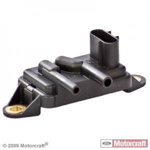

why do i have a high PFE sensor signal? what does that mean? do pfe sensors usually go bad?

Are you sure you don't mean the DPFE voltage is high?
yes. i'm pretty sure that's what i mean.
This is probably what you're going to end up having to buy. Right at $70 but I can go out in the garage and look to see if I have one in the tool box. I sent one to Laser one time but mine was Gen 1 and he was trying to put it on a gen 2. Kinda hard to get to but it is doable. Rockauto BTW
i swapped the computer and drove around the block. no codes yet.
and yeah, i've got one of those ordered. should be here tomorrow.
i already have the hood off and wipers removed. it'll will be easy when it gets here.
It's good you have one ordered because I don't have one like I thought. The part I have in the toolbox was the EDIS from the 93. Laser got the other DPFE I had. It was a few years back so I couldn't remember if I had it or not. You can take the chip you have and put it in the DZA1 and it will then be identical to the W3Z2 you have the chip in. None of the good stuff about the Z2 matters anymore when a chip is installed.

the egr ford gave me was the wrong one. so tomorrow they are trading it for the correct one. in the mean time, took it all apart, cleaned out the hoses, reset the computer, and drove around. no codes. wish the idle was higher though.

went to the (closed) ford parts department and my guy there went in, dug through the shipping boxes, pulled my parts, called the guy who ordered it to make sure he had the right one, and brought it out to me. :eek: nice! :cool:
so its installed, and all back together. had to splice in a new wiring harness, but that's no issue. so far, so good. no issues.
