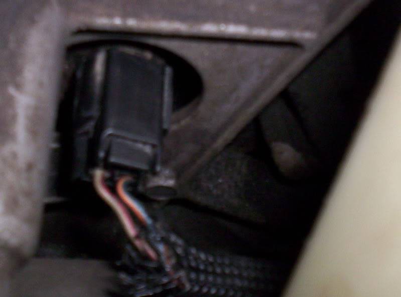

Just my two cents, but I think that somehow when you moved the PS pump you did something to the harness for the cam sensor-check the wiring, maybe disconnect the battery pos and neg cables and hold the lugs together for a few minutes to reset the computer...gremlins like this are the reason for a really good battery, alternator, connections (especially grounds)-good luck
i agree its probably the cam sensor harness..its right in the area you were working
the sensors themselves are idiot proof, its doubtful between the three you have that all three would be bad.

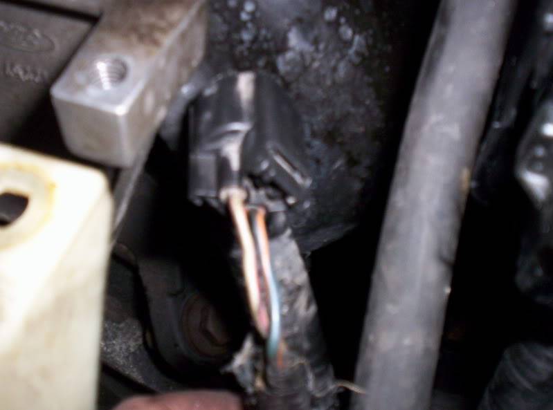

Pics of the cam sensor wiring:

Try to check all electric chain from cam shaft sensor to main computer.
In my case broken wire was under cover. I have been compelled to remove a braid from wires and check it by eyes.
