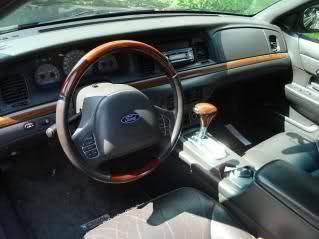

Yes it can. But I would HIGHLY reccommend against it!!!!
I have about 10 hours in total in fab and removal and installation. I got it to work, and think it looks pretty good. Im happ for now.

Nope. Its from another taurus. now all my cars have matching woodgrain steering wheels and shifter handles. lol.

What year Taurus did you get the shifter from? Did you swap just the woodgrain part or the whole assembly?
Steering wheel is from a Collectors Edition, that has been modified to fit my gen 1.
The Shifter handle is from a 03+ Ford taurus limited, and is a direct swap in a gen 2. All you have to do is wire an o\d button. However, it is NOT a direct swap in a Gen 1. I swapped just then handle not the assembly.
did u get the wheel redone in black?
looks nice
im digging that shifter knob...might have to grab me one for mine :D
