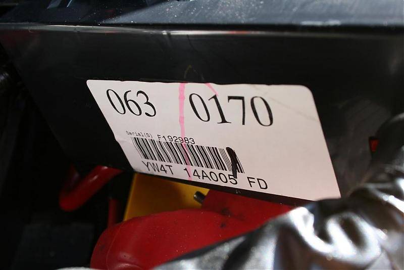

in my search, i did find a label stuck on the botom of the rem. no idea why it would be there, but nonetheless, maybe it.s the code. i'll post a picture in the am.
I believe they can look up the PCM using the VIN and then any OASIS updates to the PCM code.
Yeah, so I call the dealer with my VIN. They tell me my pcm code is 9WHABAHA
I think that's the code for them laughing at me?
Here is the label I found under the rem:
