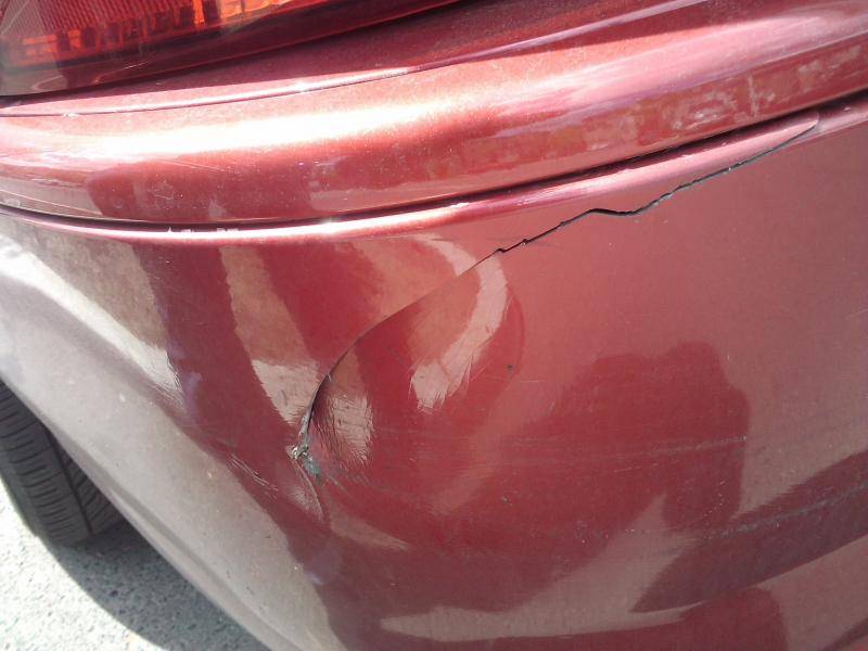

Also, sometime ago I ended up crashing into the median guard on a freeway due to a car cutting me off and me, being unable to swerve out of the way safely, I spun out and hit the median. I got a crack on my bumper and was wondering if it was fixable with JB Weld or something. It seems to just be the cover and not the actual bumper.
