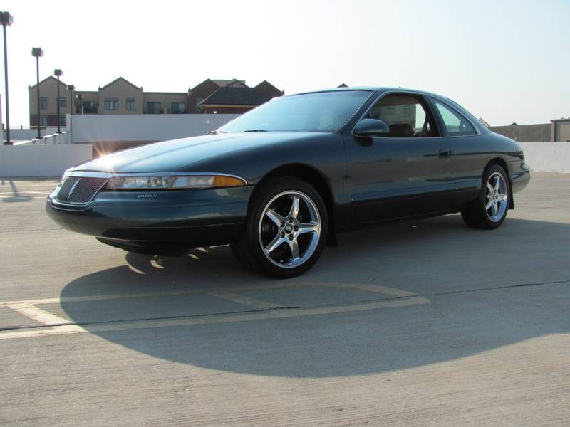

Here's how high the drivers side front was
Compared to passenger side..on even ground btw
