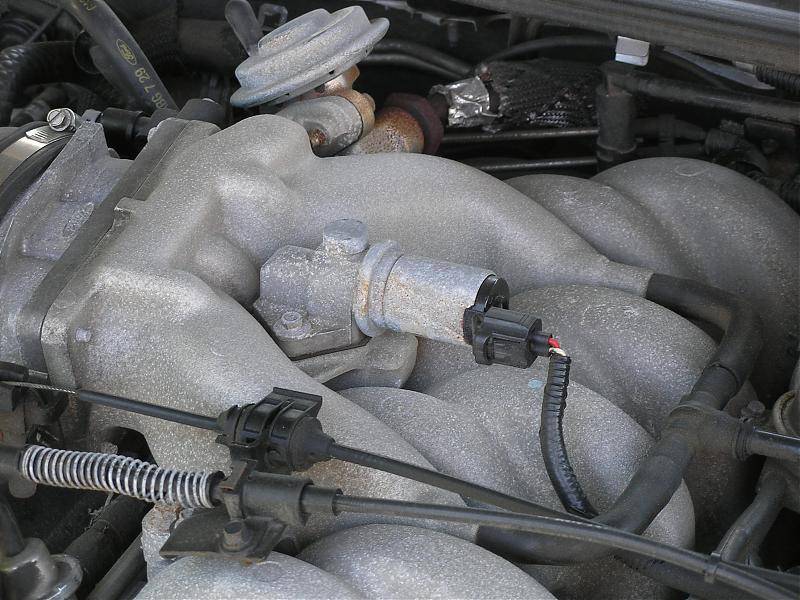

99% of the time its the IAC, ill go snap a pic
Ah got it. How much does a replacement cost and is it something I would be able to replace myself?

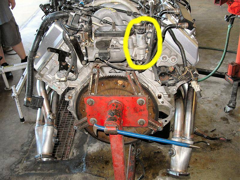

im not sure 50-ish? 1 connector and 2 bolts, be glad you have a gen 2
here is a gen 1 as looking from the firewall foward :)

Ok thanks for all the help, I'll replace it. Lol and believe me, after the first two times it died it was california stops all the way home.

Ahh... so that where its at. I think my iac is playing up also but i disconnected the wrong harness. (the one other side of the throttle body) Can they be cleaned up ok? Worth a try before replacing.
Thats a good point but i didnt want to risk replacing it only to find that it hasnt solved the problem so i figured id clean it first and take it from there. I assume the wiper cowling would have to come off to access it easily. ( i have plenty of time on my hands at the mo)
Yeah, and the TB too, hope you have better luck than I did and I still couldn't break one of the nuts loose instead fractured my finger so I just sea foamed the sh*t out of it and keeping my fingers crossed, good luck with yours,:D
Good luck with that Id rather replace it just for peace of mind cause it SUCKS to change on a gen 1
Thanks for the info guys. Yeah i agree it looks like a nasty job. I will take a look tomorrow, see what happens.
