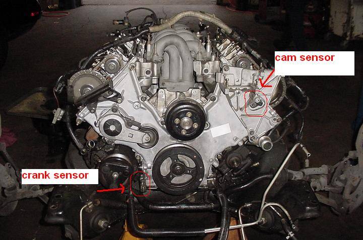

I'm going to guess your crank sensor is going bad, I've had a couple Mark VIII's with those exact symptoms and that was the fix.
This might help.
Changing it is fairly easy, you just need to get under the car and get the A/C compressor out of the way. I've uploaded the instructions from the workshop manual.

Check the wire harness there too
They're known to fail too

The sensor hasn't show any codes I had it checked and my mech. said it looked fine, wouldn't it show a code if it was bad?

Never seen a code for the Csps on the cars I've worked on

Just my experience-crank sensors at speed are cooler since it gets a lot of air, but heat sink issue can cause it to get weird at lower speeds. No matter what, it is not going to throw a code and it is classic symptoms for a crank sensor-easy enough to do, if it takes a half hour you took your time. Worth a try.
