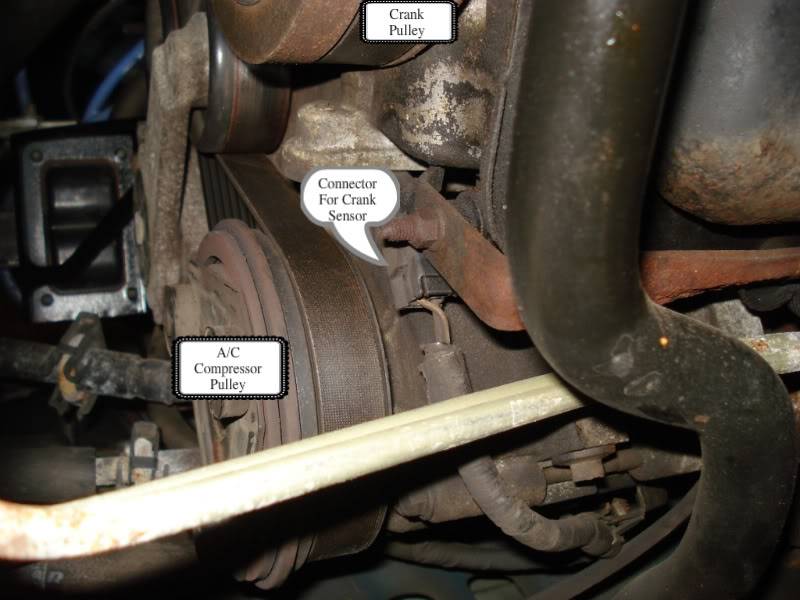

Here we go: (view is from underneath the car)
Hopefully, when you washed the car, the connector just got damp.
thanks 93 that pic helped a whole lot. unforunetly that was not the problem. im thinking its either the fuel pump or the fuel filter. are our fuel pumps inside the tank or outside? also i tried following the fuel line to find the filter to see if it was clogged but was unable to find it?
