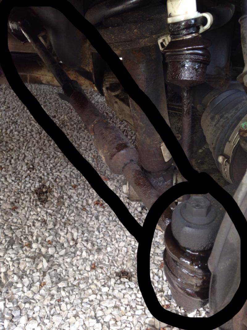

Can someone please tell me what the correct term is for this bar under my LS? (PIC)
I replaced mine recently to eliminate noise. The old parts were pretty worn, and my 06 only has 80K on it.

If you would of noticed when they first started to crack, then the dust boots could of easily been replaced. At the stage yours are in they have already allowed dirt and moisture into the joint and should be replaced. When I noticed the first crack I replaced mine with the accordion style boot(see pic) that I had saved from my 01 taurus sway bar link, but I have see many sites that sell the dust boots separately(They list them as tie rod/ball joint dust boot/cover) and come in many sizes and styles.View attachment 828467911
