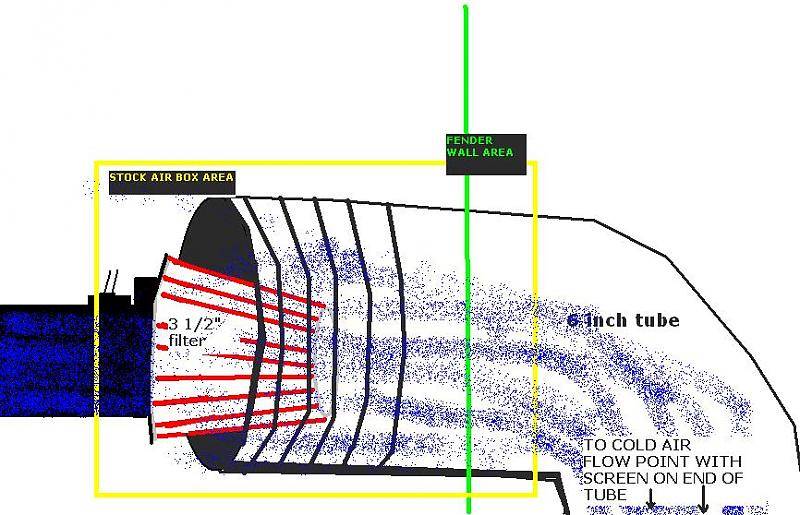

this is my idea, leave the stock tube on the gen 1 and put a cone filter on the end, then to assure no engine bay heat, i place a bigger tube that would fit a little loosely over the filter, so the air would be directed from the cold from the fender area into the filter into the intake, what do you think
Ok, if you want to do this, and do it right.
you dont want ANY bends in any tubes 4inches from the maf..minimum.
This will give you the best results without corrupting the maf signal.
If you put the cone filter directly on the end of the maf, that will allow air to enter the side of the filter, and will be just like having a 90 degree bend JUST before the maf.
relocate the maf, get minimum 4 inches of straight pipe on each end, then route the pipe outside the engine compartment.
there IS merit to getting cold air to the engine, but you want to make sure you dont cause "other issues" in this quest for cold air.
I hope some of this helps.

yes, it helps, i wont be doin this today, but its good to know about the maf, thanks
Do a search. People have routed the filter itself to the bumper or fender and people have routed tubes from the bumper into the engine bay.
One person even used his stock box with the bottom cut off and placed it behind the bumper grille.
Your best bet would be to use a tube going from the bumper to the engine bay via the hole in the fender well. That way anything that does get into the tube gets lost in the engine bay rather than go straight to the filter.
Even then its a bunch of mixed emotions, some say the difference isnt even noticeable and some say it is.
yea, that makes alot of sense to about the filter too close to the maf sensor, how come alot of people havent noticed any issues, you see alot of intakes with the filter right after the sensor... so it would be stock tube, maf sensor, 4 inch of extension, then cone filter. how does the stock intake box even out the maf sensor, because that filter it right about after the maf too, but i know its not an open unit so that could be the difference rather then the cone with the open sides
Nice illistration.:D
