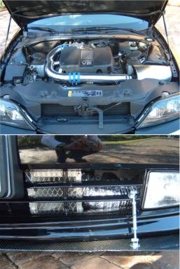

my setup is similar to grayghosts, but i put a large square funnel on the end by the fog light. Sorry no pics, can't get my computer to upload to lvc today.
Also i didn't cut a hole in the air box, i just sawed the factory pipe in half and fastened my flexhose on the end of it. Should i wrap my MAF to Intake hose with heat tape..... proly would keep the cold air.......cold

I wouldn't bother wrapping the intake tube. The only time the intake charge will be impacted by underhood heat will be at idle or low speeds. At any other time, the speed at which the air is travelling will overcome any of the heat on the outside of the tube. The biggest concern would be the temperature of the air that is at the inlet of the air tube.
One other thing to consider. An air source mounted too low will inhale higher temps than one at behind the headlight. Why? Because the closer to the asphalt you get...the higher the temps. That's why you never saw factory cold air systems pick up air from below the front bumper. The only one that I can recall is the 66-67 Olds 442. From then on, it was either from the top of the hood (front and lower pressure) or from the rear (cowl induction and higher pressure) where the air was cooler. All of this will hold true...even at speed.
