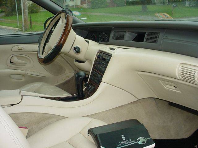

If it's an LSC it's at least a 95, there were no LSC's made in 1994. Do you have the double DIN radio? If so, it's a 95. 93 and 94's had the 1/2 DIN radio. If it is a 95 LSC with that few miles for that price then snap it up as quickly as possible, these people do not sound very bright. See the radio in my pic? If it looks like that it is a 95, not a 94. This is a shot of my 96 which looks the same as the 95. And that hideous steering wheel cover is no longer there :wrench
