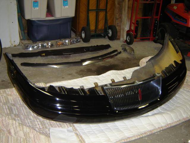

Here is a picture of when i took my bumper off.

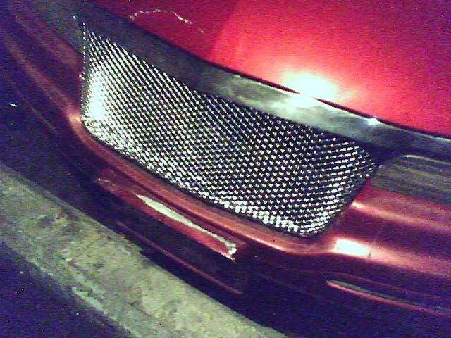

I needed the info badly. i just put a mesh grill on the mark and here is a quick photogrill.jpg of what it looks like. i need a paint job badly and that will be coming in two weeks. once that is done i will post pics of that as well.......
That looks pretty good, I made one up exactly like that awhile ago. It needs some sort of edge surrounding the mesh though (maybe not on the top since the chrome piece is there.
I agree pretty cool. If the edge is rolled nice enough, maybe the edge could be avoided.
May need to bow out abit to match the shape of the front of the car.
yea i agree. i tried beding it but this stuff cracks if you bend it too many tmes so i was being really cautios. i cant think of hat to put around the edge thogh but i will look into it.
