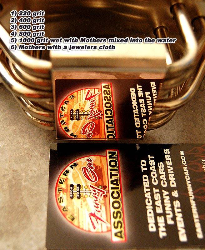

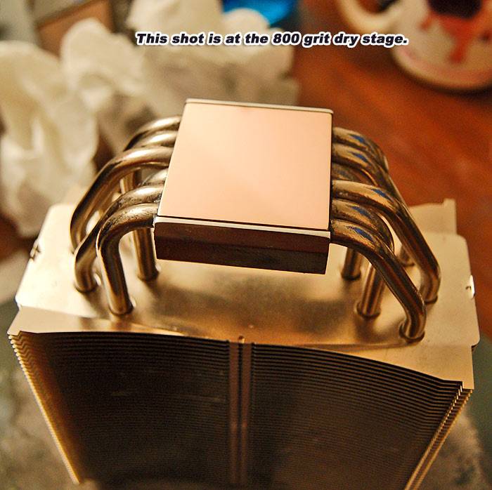

Lapped the heatsink, check it out.
Heres the build so far, waiting on the raptors. Still undecided on the OS. Hate to install the W7 but it will be gone in August. I do not want to get all my stuff installed and updated then have to start over again. What OS for now until W7 comes out?
You are outrageous. What exactly is lapping the heatsink?
It is the process of sanding down the bottom of the heatsink to as perfectly flat as can be. ALL of these high dollar amazingly engineered heat sinks all have round bottoms where sometimes as much as 20% or more contact is missing. Do you know what that can do for heat disappation? You would think the way these look and the prices they get that this would ALREADY be done? Makes no sense.
Look at this video of my exact heat sink the Thermalright Ultra 120 Extreme.
YouTube - Why you should bother lapping your Heatsink?
It only took an hour and is perfectly flat now, 0 light got through any angle using a straight edge.
