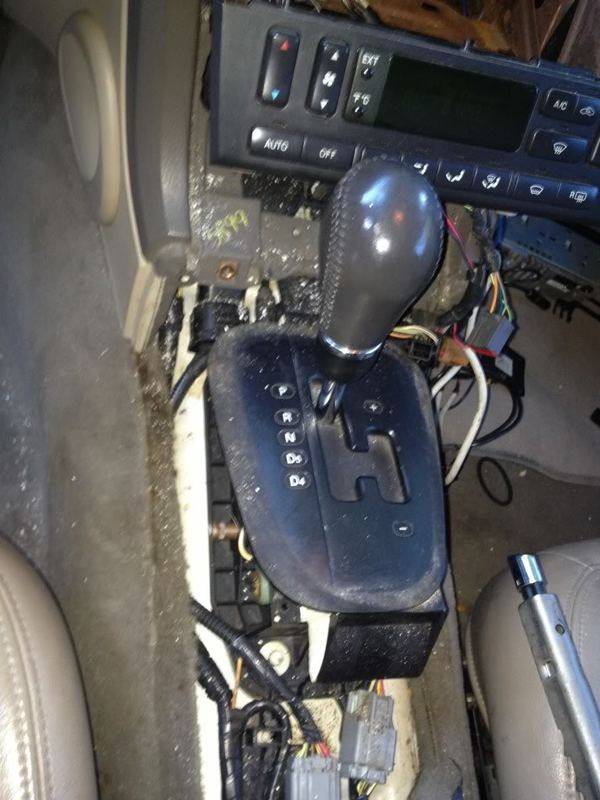

The center area of the dash is in rough shape, has a really cheap alpine aftermarket head unit, wiring was hacked instead of factory harness adapter, and the bezel around the center vents is gone. Also had misc bolts missing when taking apart the center console and radio area.

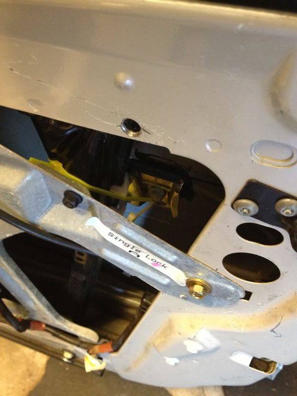

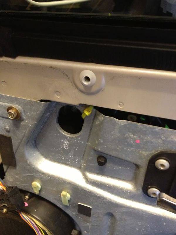

Front windows didn't work. Found out that regulartors were bad and the owner zip tied the bracket on the glass to the top of the regulators! Seriously, regulators are about $60 a piece.

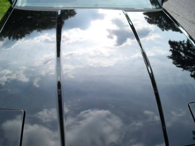

And make it look like this

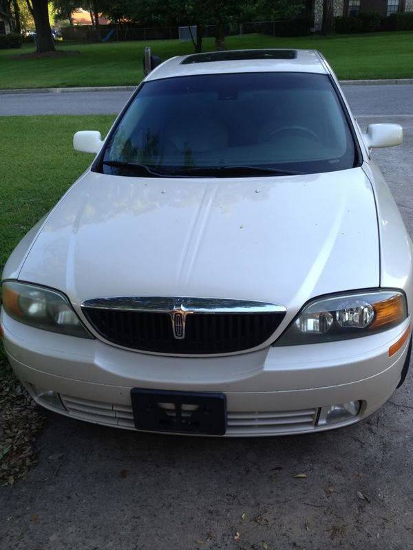

Here's some pics of what she looks like now.
You can see I made a half ass attemp at polishing the one headlight just to see if I needed to sand em.

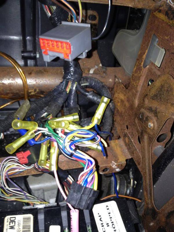

Here's the hacked radio harness. I don't understand why people just don't spend the $10 for an adapter harness. Soooo much easier!
And here's a couple shots of the great zip tie job

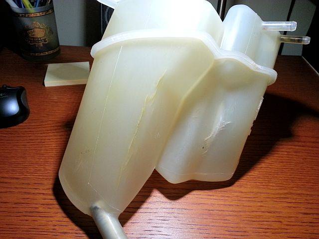

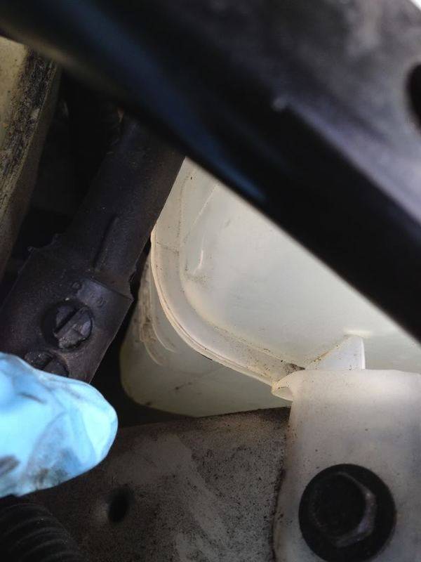

Well drove around for a bit with heater on and felt the heater hoses and they felt warm and "empty". Popped off one of the hoses and it was dry. No signs of any plugs in the hose or in the firewall nipple. However after I reattached it and let t idle for a few minutes a radiator hose blew off and I lost all coolant. Car wasn't overheating according to temp gauge on inside of car. I did find the previous owner switched to a worm gear clamp on the hose and it seems it wasn't tight on there at all. I tightened her up and went to fill with coolant and bleed it this morning and noticed what might be a small crack on the degas bottle.
It's in the section above the fill lines. I can feel it with my fingernail on the outside of the tank. The thing looks brand new compared to other parts of the car, but I'm not going to take a chance. I'll order a new one and the refill it. In the mean time I'm going to check under the car on the dccv to see it it was plugged down there.
Yeah, it's done, it won't allow for the system to pressurize and thereby not getting into the heater core for interior heat.
It will have a few cracks on the back side against the firewall like everyone elses Degas bottle.
http://www.lincolnvscadillac.com/forum/showthread.php?88661-Re-amp-Re-OEM-Degas-Bottle-GEN-1-V8
Do not buy the Dorman bottle, too many reports of cap not sealing correctly.

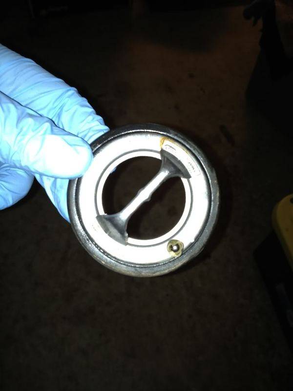

So, change out he thermostat housing. It's a little project, but wasn't too bad. But now I know the guy was plagued with it running hot and didn't know what to do. He was an old school car guy (had a tri 5 in his garage he was working on as a project) so probably wasn't too keen on how sensitive these cars are to cooling pressure or how to look up the problem online. When I opened up the thermostat house I found this.
He gutted the thermostat probably thinking it was the problem. So I replaced the crossover tube, degas tank, thermostat housing, and changed out all the hose clamps.
Either way, car runs cooler and the heat is working! Now onto cleaning this thing up and putting the interior back together.
