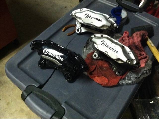

Small rotors and weak one-piston calipers are mostly to blame. Our brakes are TINY considering the weight of the car. A Cobra brake conversion is the best option. Other ideas presented here will improve the condition. I second the idea of slotted as opposed to drilled. You still want to retain as much surface area as possible on your rotors for braking power. If you are not in the market for Cobra brakes, I would try the EBC pads with slotted rotors. I have heard of a few that have done this with good improvement and at least one of these guys has a pretty quick modified all motor Mark8 that frequents the drag strip.

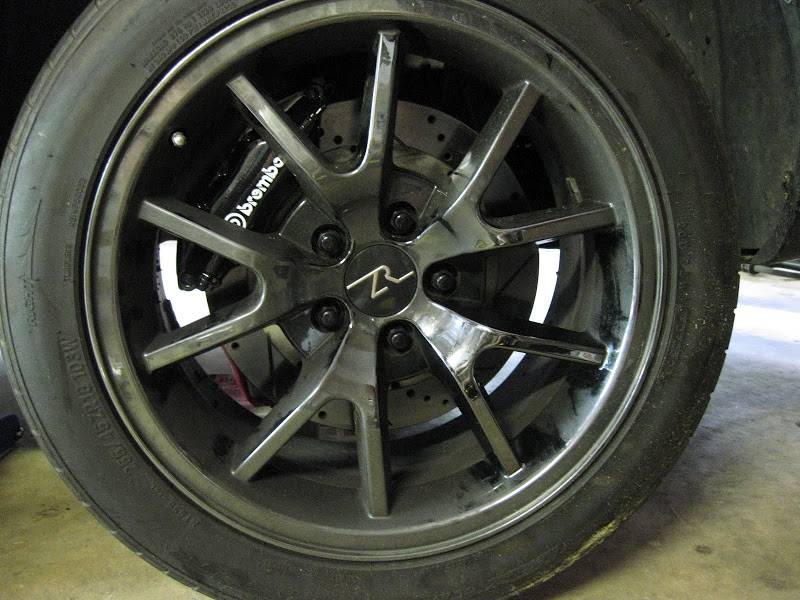

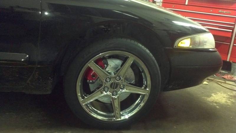

I upgraded to bigger front and rear rotors, cobra dual piston calipers, stainless lines, and hubswapped and still feel I need larger front brakes...will be upgrading to 14" rotors with bigger front brakes down the road. The cars feels as this setup I am currently running should have been STOCK.
No regrets, but 14" Big brake upgrades are where its at....
