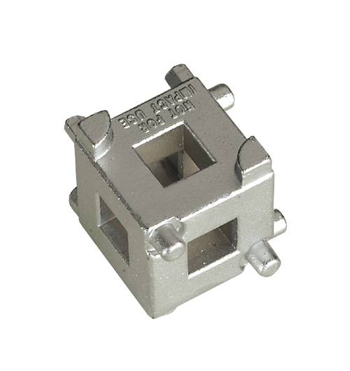

thanks guys i want to know if they were hard to install not hard to make. do you have to pack barings or anything? thanks, Mac
not hard to install. the bolts to remove the caliper mountings are a little tough - torqued and hard to reach. the rest is easy.

mcafferty said:
do you know what the tool is called so that I do not get into the job and then have to stop and go get one? thanks so much guys...
the expensive one :
the cheap one (I have):
it's called a Brake Piston cube 3/8 sq drive.

can you just compress the calipers back? will this damage them at all? what does that tool do for the back brakes? thanks one again guys i think i will go with the slotted only. any pads better then the next?
nope - you can squeeze in the front pistons but the back are 'screwed' in (due to the parking brake) - the tool lines up with notches in the piston head and allows you to turn them in with a racket. if this is the first brake job - they'll be stiff.
