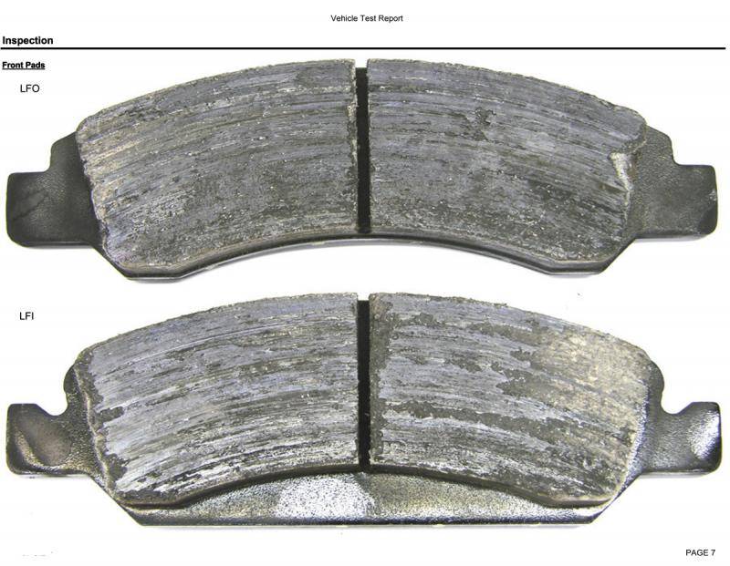

It’s hard to tell in these pictures but while the pads look shiny, I don’t think they are glazed. Below are examples of glazed pads from a test.
Glazing occurs when the organics in the friction compound vaporize and deposit and the rubbing surface requires a good amount of heat. With a higher organic level at the rubbing surface, you generally develop a lower level of friction, but no so much noise. The sanding of the pads and rotor surface does remove the glazing, s will about a dozen or two of low temperature brake stops, but the reduction in noise is generally due to the rough pad and rotor surfaces now having less brake friction now that they are “green”, transferring the work to the opposite axle. Once the pads and rotors are smoothed from braking activity and friction material transfer to the rotors surface re-establishes (which is normal), the friction returns and often so does the noise.
These pads may be normally shiny due to their density and lack of porosity. We would alter a pad formula’s porosity during manufacture to reduce noise development, but with rotors that have slots you need the denser, stiffer pad to prevent the friction material from wearing excessively as the slots wipe across the pad rubbing surface, basically shearing off material.
