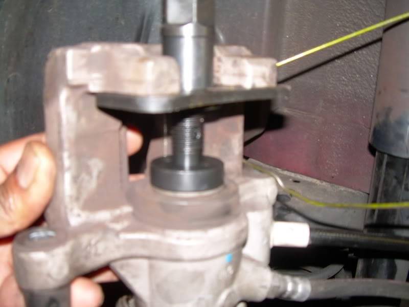

you have to rotate the rear piston as you push in.
i use something like this.

Just goto Vatozone. and borrow the ford calliper tool and twist it in. when i first got my mark i almost ruined my trying to push them in.
I hope Autozone in Miami let's me borrow it, otherwise I'll have to purchase it which more than likely I will do so I have it stored for every time I want to do my brakes.

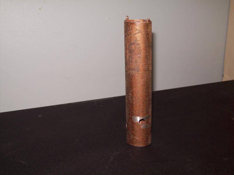

spanner
One night I was doing rear brakes on my 95 and I learned about turning the piston in to reset it. Found some pipe and made a spanner wrench. Crude, but got the job done.
