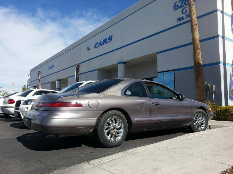

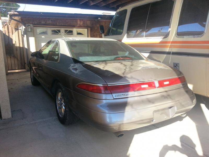

I got a 1996 Mark 8 LSC with 82k miles and the only problems I see are the paint, the blend doors making noise, the tach doesn't work, and the turn signals. Other than that, the air ride is in good order, windows, sunroof, seats all work good brakes, rubber and belts. Smells of oil through the vents, no smoking or leaks though.
Its going to be my DD until the Audis get out of the shop. I know a lot about.these cars, but I am completely new to this. I am looking to gain knowledge from all of you that have been doing this with this car much longer than I. Thanks in advance. Go ahead and offer advice, what to look for, what to do.

What is the difference between LSC and normal? Are there any definitive ways of telling for sure? Or just a VIN search would do the trick? Thanks, driller
perforated seats.
true dual exhaust.
deleted bumper and molding chrome trim.
3.27 gearing.
HID headlights on 1 gens.
monochrome front grill, headlight trim, and tail light trim on 2nd gens.
10 hp bump
LSC badging
It has true dual and HIDs and chromeless bumpers. And the badge. I'll check out the seats. The man I bought it from was probably 85, so it may actually be a real LSC
Perforated seats, check.. looks like trac lok, gears and exhaust with tuning are next. Thanks for the help, guys. Im in las Vegas any recommendations for tuning and such in my corner of the country?

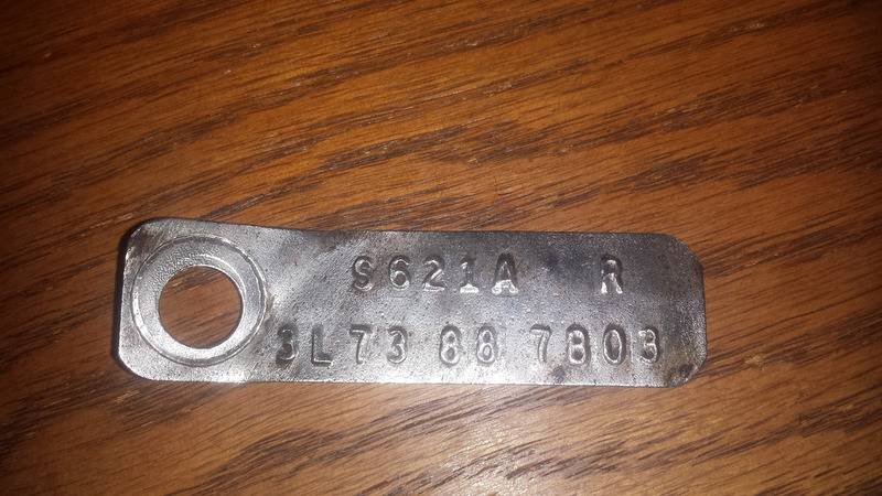

Trac-Lock will be identified (if equipped from the factory) by the letter L in the bottom line of the axle buck tag (attached to the differential rear housing by one of the cover bolts). IF it were truly Trac-Lock, it would read 3L27 (space) 88 (space) four or five build digits. The first 4 digits of the lower line of code are gear ratio and whether it is Trac-Lock equipped.
Yes, that is indeed a 3.73 Trac-Lock 8.8".
3L73 88 is the proper code for that.
