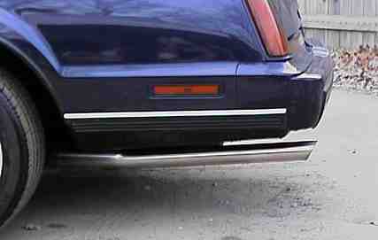

Most of us started with a two or two point five Mustang exhaust and then streched it to fit the Mark. Here's what a custome shop did for me in 2.5 inch tubing.

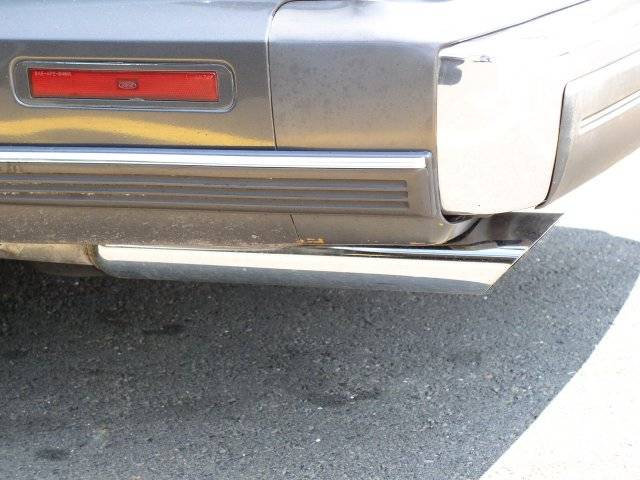

Is that driver side pipe a bit more to center than the other side?
I don't see how they'd avoid the bend since it looks like you still have the spare tire compartment. .. maybe me eyes are playin tricks..

No tricks at all.
My install was a bit BASTARDIZED due to the fact that I requested 2.5 inch tubes and requested that they start with a Mustang kit and the fact that I drive a Sporting Coupe that was designed for comfort and luxury more so than increased exhaust. A true custom install would have had about six to ten welds intead of the sixteen to twenty or so that you see here.
Lastly, you have to see the entire install AND understand the underside of a Mark VII with stock suspension and stock fuel tank to understand why things are askew.

Well, Damn...they could've given you a little bend there, to line up with the other side. ;) What's the matter with them? lol

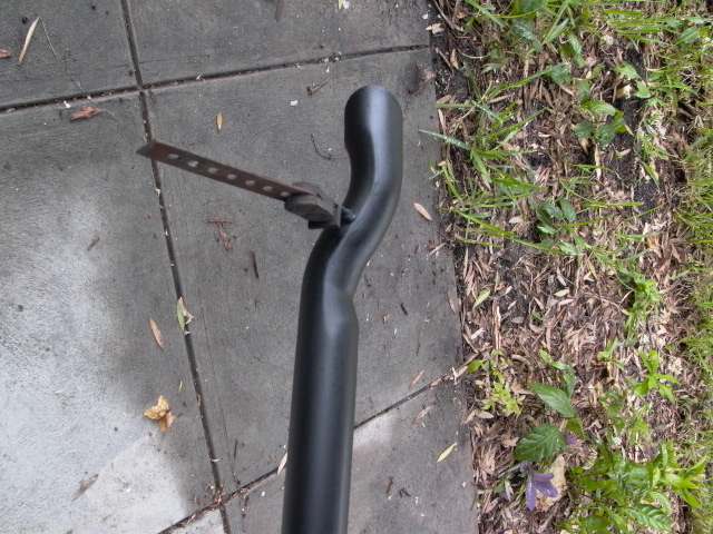

I transfered the rear T-Bird suspension this weekend so I snaped this pick of driver side exhaust kink they did for me in 2 1/2" pipes.

That's pretty beat, man. :( Mine's all 2.5", over the axle and everything and there's no kinks anywhere.
lol. . then, I'm just more "kinky" than you are.
