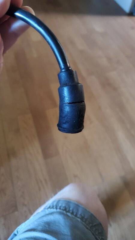

As part of the V6 spark plug/cop access, you have to pull the intake manifold upper plenum, which is highly disruptive to the top end of the engine with the amount of hoses and cables to disconnect. There is a PCV line that runs from the back end of the engine, driver's side, across the upper plenum, and it connects to the throttle body. The hose is about 5/16" or 8mm and stiff plastic, but the ends are rubber boots that accept the 5/16" hose on one end of the boot and and convert it to 5/8" to make the connections to the PCV system under the intake and the throttle body. On my V6, that hose adapter at the back end of the engine was significantly cracked and caused a very rough idle once the engine got to closed loop operation. It would sit there and shake like a top fuel dragster engine at idle, making the ugliest popping noises and nearly stalling. Ran like a champ for driving and power, but could not idle down while coasting until the car reached a full stop. (std trans) Well after I found this problem, the car now behaves properly at idle and running/coasting. I would imagine that many of the V6s have this problem.

But you can easily rule this out on a temporary (very temporary) basis by removing that hose from the throttle body and plugging the fitting in the throttle body with a piece of a plastic bag, for example, and reinstalling the hose to see if the problem still exists, perhaps even trying this as you've pulled over from it just starting to occur, since you don't want your crankcase to build pressure too much. The problem could also be in the nether regions of the intake, underneath the lower intake where the PCV valve is. There is another weak link in the system where the PCV connects to that 5/8" metal tube that brings the flow to the rear to front hose that we are talking about. It's a small 90 degree elbow of 5/8" rubber that tended to dissolve into soft rubber and leak badly.
Thanks for your info, have replaced all of this with motorcraft parts. not much that I have not replaced on this. will double check though as this stuff is subjected to a lot of engine heat due to everything being crammed together tight on these engines and engine bay.
