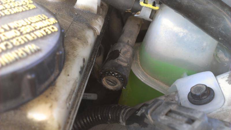

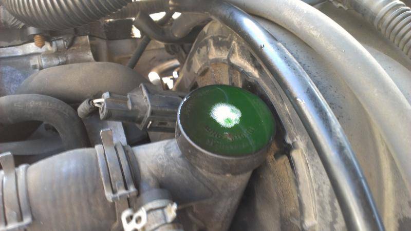

Hey sorry I'm still not getting a clear idea, no offense to anyone I'm just kinda new to mechanics, I replaced my radiator but not sure exactly how to bleed so I took pictures of the degas bottle because I don't know if it should b that high while bleeding. And the the engine fill has bubbles coming from it... There's a whistling sound coming from the engine fill area...
Your engine fill cap is clearly cracked. You will never get it to work with the cracked cap. You'll have to replace it. (This would be a great time to switch to the Jaguar metal cooling tower and cap.)

And yes, you're supposed to put as much as you can in the degas bottle. If everything goes correctly, it will drop to the correct level after you are done and the engine cools off.
