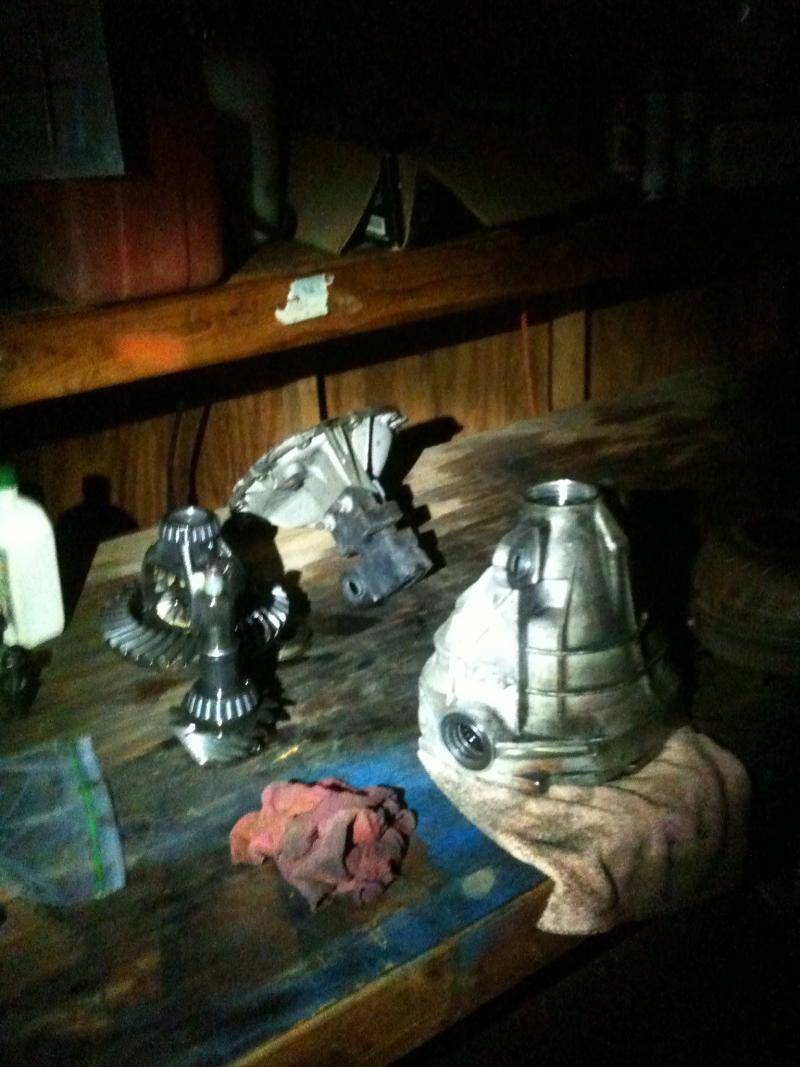

Dan i have the pumpkin out, i am just worried if my gears are good, they look good but i know that the pinion nut was loose that can not be good on the gears.
How loose we talking on the pinion nut? The most important thing is if the gears were quiet, then they should be fine. Once they start making noise, it is pretty much impossible to get them to quiet down. If you had no problems before the removal, I'd just use what you have.
pics all dun in 3.5 hours
How does the wear pattern on the gears look? If it looks centered on the ring gear and smooth, no pitting, then I would reuse them. Not trying to condescend, but you do know how to properly build a rear end right? Just another one of those things that takes special tools and some experience to get right the first time.
