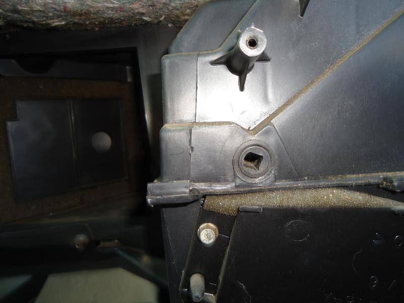

There are two possibilities.
The first one is that the plastic gears in the actuator itself are stripped. They put grease on the gears and eventually it causes them to break.
The second and worse possibility is that the square arm coming off of the actuator has stripped the hole it goes into. If that is the case then the repair is much more involved but fixable.

if its the worse possibilitiy. what is the "hole" and how do you fix it?

Here's a pic of the hole the actuator goes in on a 96.
I would be removing the actuator to examine first to find out the exact problem before removing the entire dash.
