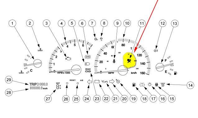

Start the car and look on the instrument cluster and see if this light comes on for 5 seconds and then goes out.
It should just come on solid for 5 seconds and not blink thereafter, does it ?
The AirBag Readiness should momentarily illuminate when the ignition is turned to the RUN position. I suspect the SRS system may have a fault.

I've never replaced the clock spring, and yes that particular light stays on for 5 seconds then shuts off. The battery, oil, and engine picture lights stay on however.

Battery, Oil & Engine lights should stay on while in the RUN position, they should go out when started though.
What about #9 in the above picture, the seatbelt one, same thing ?
----EDIT: what I meant is, it actually come on before it goes out.

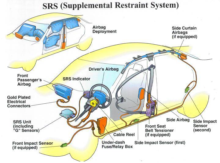

Not sure what to tell ya, everything I've read on this beeping subject leads to a fault in the Supplemental Restraint System (SRS)
There does appear to be a Fuse/Relay involved in the above pic but it's not LS specific, we'd have to check.
If it is related to the SRS, it's important that it get corrected properly so as during an impact the airbags will in fact deploy.
The fact that it doesn't do it when you click the seatbelt tells logic thinking that it's related and could even be as simple as a cut wire under the seat.

Additional info,
Restraints Control Module (RCM)
The restraints control module (RCM) is mounted on the center tunnel under the instrument panel. The RCM performs the following functions:
- signals the inflators to deploy the air bags in the event of a deployable crash.
- activates the belt retractor pretensioners to remove slack from the safety belt webbing.
- monitors the air bag supplemental restraint system (SRS) for faults.
- illuminates the air bag indicator if a fault is detected.
- flashes the air bag indicator to indicate the lamp fault code (LFC) detected.
- communicates the current or historical diagnostic trouble codes (DTCs) through the data link connector (DLC).
- signals the instrument cluster to activate a chime if the air bag indicator is not available and another SRS fault exists.
- contains an internal safing sensor which is not serviced separately.
The RCM monitors the SRS for possible faults. If a fault is detected while the ignition switch is in the RUN position, the RCM will illuminate the air bag indicator located in the instrument cluster.
When the ignition is cycled (turned off and then on), the air bag indicator will remain lit for six seconds and then go out. If an SRS fault exists, the air bag indicator will then flash the two-digit LFC associated with that fault. The air bag indicator will flash the LFC five times, then remain illuminated for the rest of the key cycle. The RCM will also communicate the current and historical DTCs through the data link connector (DLC), using the New Generation Star (NGS) Tester. If the air bag indicator does not function, and the system detects a fault condition, the RCM will signal the instrument cluster to activate an audible chime. The chime is a series of five sets of five tone bursts. If the chime is heard, the SRS and the air bag indicator require repair.
LFCs are prioritized. If two or more faults occur at the same time, the fault having the highest priority will be displayed first. After that fault has been corrected, the next highest priority fault will be displayed.
The RCM includes a backup power supply. This feature provides sufficient backup power to deploy the air bags and belt retractor pretensioners in the event that the ignition circuit is damaged in a collision before the safing and air bag sensors determine that an air bag deployment is required. The backup power supply will deplete its stored energy approximately one minute after the battery ground cable is disconnected.
