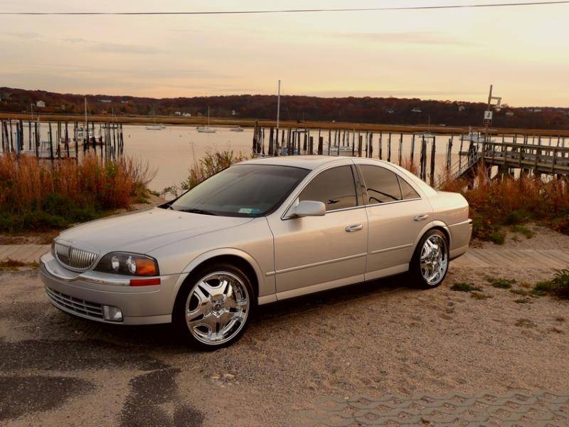

49mm on the 8.5" wide Sentas.
I went with 255/35s on mine and wouldn't go any narrower or wider. They contact the wheel liner at full lock. It's not severe enough to bother me.

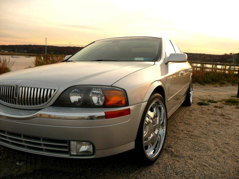

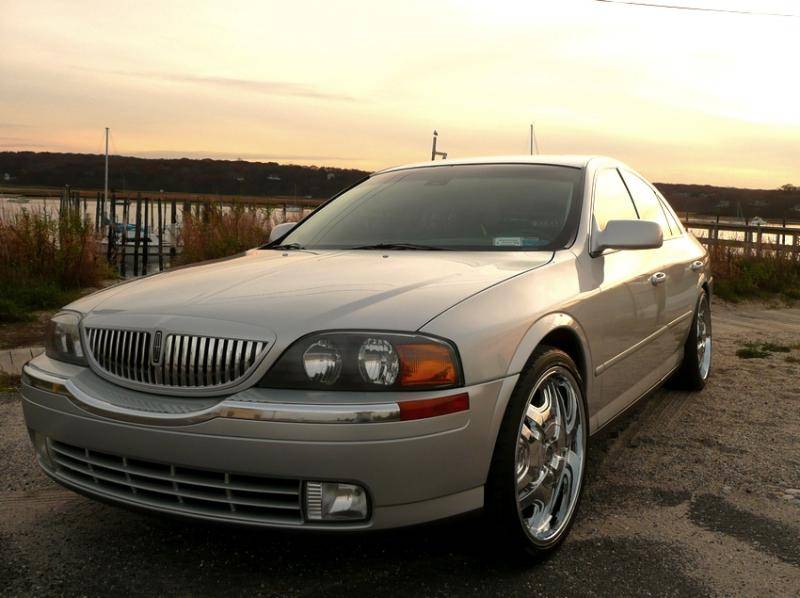

ok... i cant tell you that 235/35/20 wont "rub"...but here is my setup...
first i have a non-sport 2002 LS with 85,000 miles
...i have 20"x8.5" TIS 03 wheels...(discontinued by the way :(...)
they have a 38mm offset wrapped toyo proxys4 size 245/35/20...
so far i like the setup..i change back to stock 17's in the winter, but ive went 2 summers on the rims so far with no problems...
however, i do "rub" in the back when i have the rims on and people in the back seat... i have 3 amps and 2 12"s in the trunk so the extra weight [ 200+ lbs. maybe?] probably dosent help, but its not that bad... i only rub slightly [the tire edge rubs on the inner plastic part of the wheelwell...] over big dips in the road, and like i said, its only with passengers in the back and its nothing that has any damaging effects or anything... i have put coil spacers in between the rear coil springs to prevent the springs from compressing as much [got the idea from QuickLS] and it seems to help...but it didnt totally fix the problem...
either way i like the wider tires and i hate being able to see the lip of the rim sticking out past the tire so im confident ill never go with 235/35 tires in the future... good luck, hope this helped...you will love the way 20's look:D

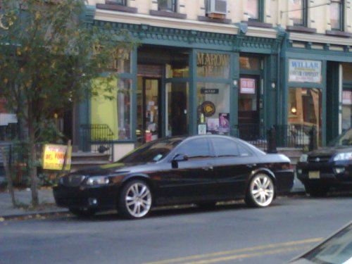

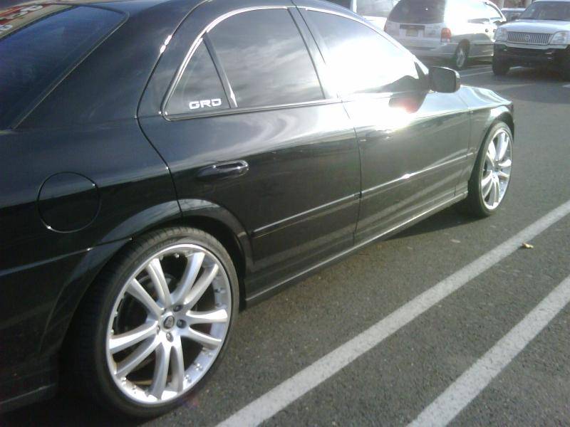

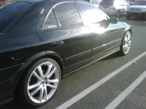

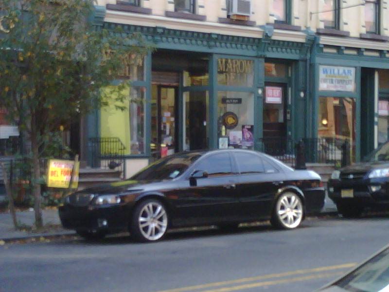

Finding attractive wheels for the LS's bolt-pattern at a reasonable price was tough. I wanted to do something different, but that's where the higher price comes into play. So, I stuck with the tried and true Jaguar Sentas. I would like to have some Jaguar Vulcans, but the wheels alone cost more than what I paid to have the Sentas mounted and balanced!
