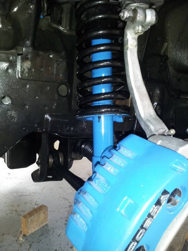

I have tokico's 1.25" lowering KIT that I'm waiting to install comes with tokico blue front and rear shocks and lowering springs..meant for the tbird/cougar..part number HPK221...look it up on eBay or Amazon..amazon is the cheapest which is where I bought it from.

good choice on the Blues!!!
