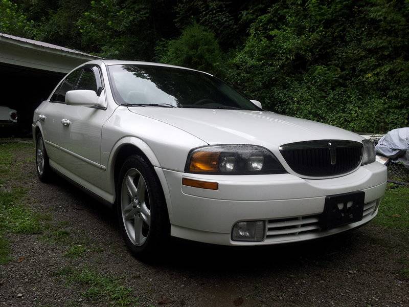

Is the car pictured in your profile page pic?
No, that is a 104,000 2003 V6 with a bad engine. Previous owners didn't check the oil and seized the motor. It was the original plan till I found this V8 car local cheaper than the engine for the 03 lol.
The car has 139,000 and with having to drain to swap in new upper and lower hoses and it being right there and easy to swap I figured what the hell. That will have 90% of the entire cooling system new. I didn't want to go 35,000 and have a water pump bearing go down etc and have to deal with it again that soon.
Wow! You're a wheeler dealer !!! That is a really clean LS for $500 I always say if I was to choose any other color besides black/ebony for the LS my second choice would be either Pearl White or like yours a nice clean White...it's truly amazing what ppl are selling these cars for on Craigslist here in MInnesota ...I was going to look at a 2006 black on black with all the extra mods for $4000 O.B.O with 157,000 I'm talking clean inside and out a real turn-key car it's funny because like this guy selling it the reason he is selling it is because it's a gas hog he said needs cheaper gas mileage....I'm not sorry to say this but your not buying a LS so to get better fuel economy...anyone who truly knows and loves the ride of this car in all its handling of turns and quick bursts of speed knows it's a car for just that enjoying a ride that handles like a dream ;-)
After looking a little closer is your LS pearl ?
Na, it's the lighting of the pic. Its the bright white. The headlights have moisture inside. I know how to fix them but probably just grab a new pair on Ebay or may look into swapping in the set from the 03 car if possible. It's a damn shame they changed the tail light sizes. Id love the Euro look of the 03-06 tail lights.
