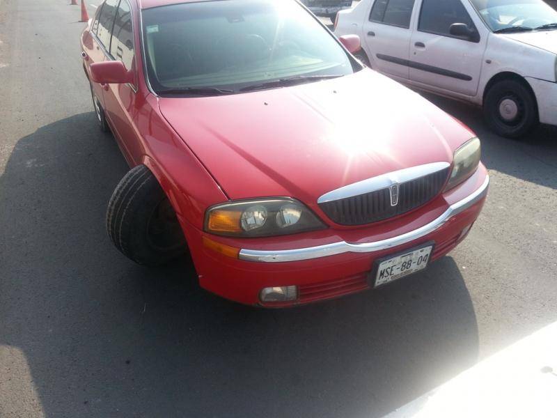

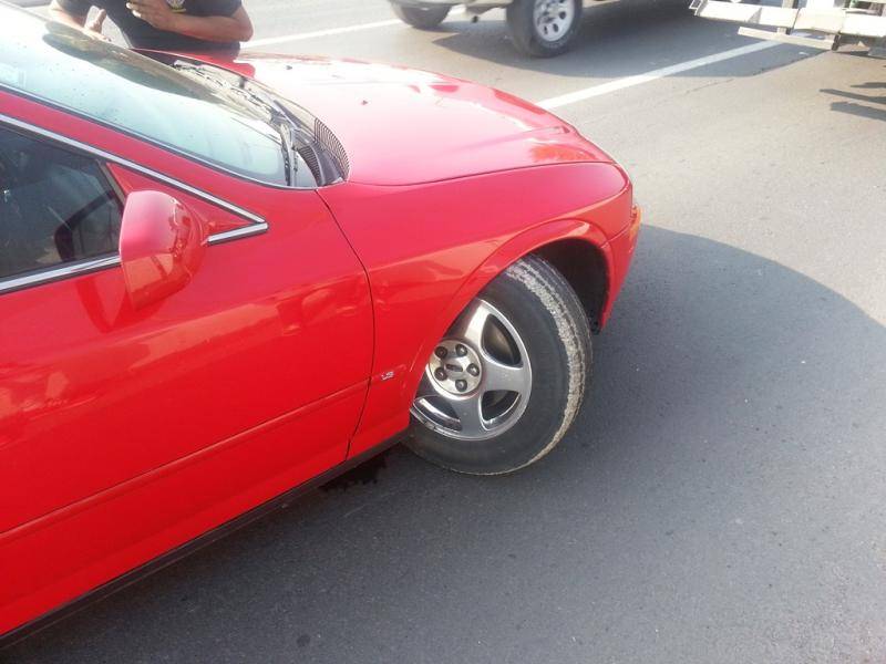

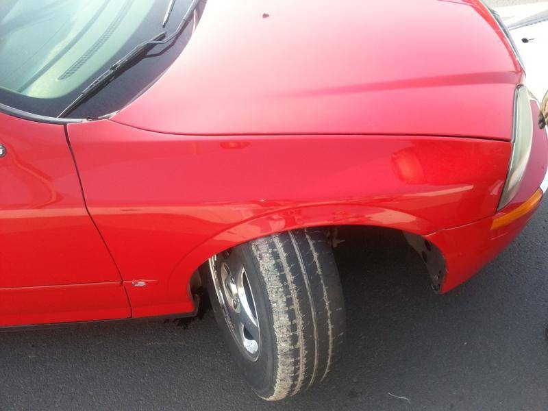

Hi!

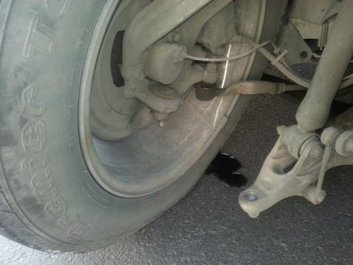

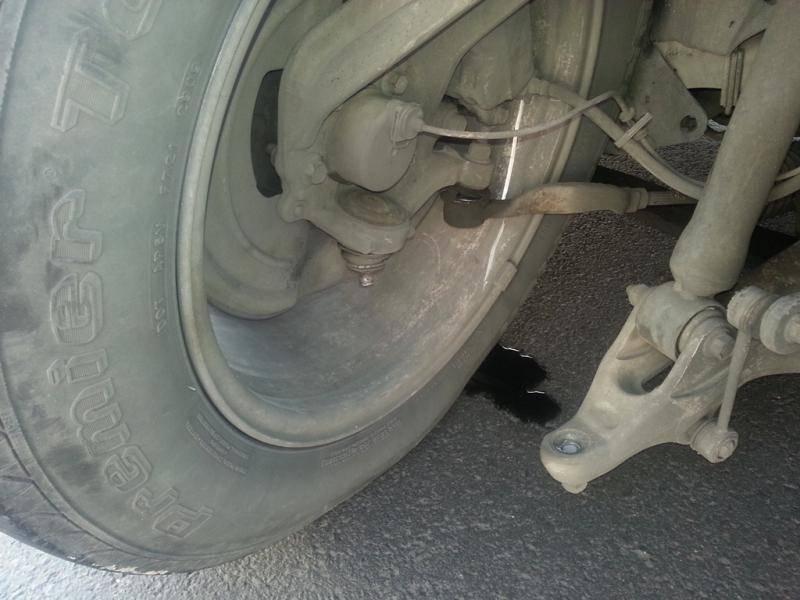

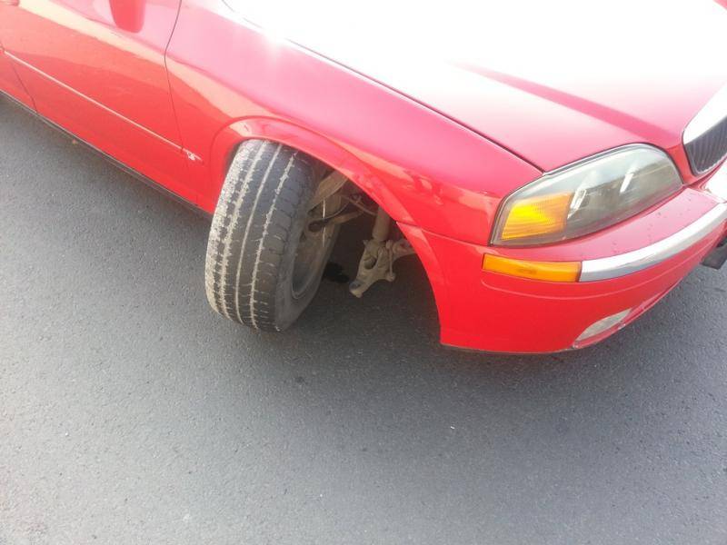

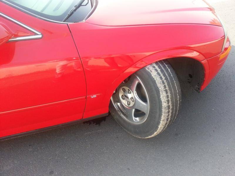

Yesterday I was driving to the airport , we were near my house when I felt a loosen steering wheel then a noise coming from the front passenger side.
Damm We were going at low speed so i could control the car.
The car slipped like 5-8 meters, we took just the essential and get out the car to a safe place.
Just a f scare, everything fine.
The car was directly to a workshop to replace the ball joint.
Now I'm waiting to buy a new suspension.

glad your ok... but you should have noticed something was wrong far before then. If you didn't, you need someone to go through your ENTIRE car looking for warn parts.
Clunking, Vibrations, metal on metal sounds...are not normal
Yes, in hindsight, were there any warning signs that your were inadvertently ignoring?
I agree, very scary...
ty!
I really don't know ,maybe I ignored something , a noise after a speed limiter , I think the steering wheel got misaligned just few time. <--- I think this is the warning you're talking about.
The roads here in Mexico are s+it , (holes)pits everywhere ,so maybe i thought it was passing through one. >_<
Upper control arm x2
inner/outer tie rod x2
sway bar link x2
ball joint x2
I'm waiting for those parts.

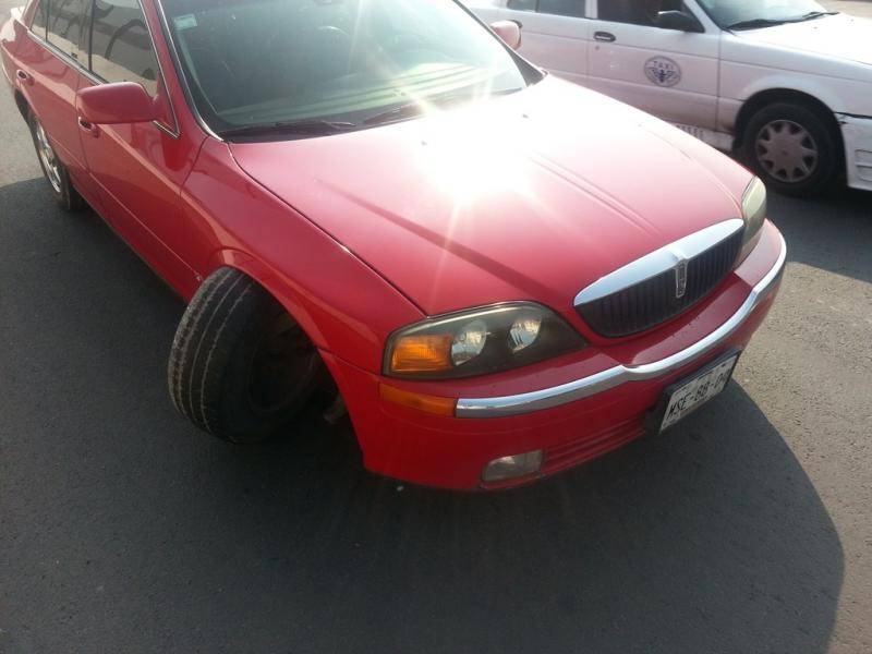

Wow that's ugly. Glad you were going slowly and are unhurt. So it's just one bolt that separates us all from disaster?
It's a pretty car though. What year is it? That doesn't look like the vivid red I know. Have u repainted it? And how many miles (kms) are logged on it? Thanks and best to you.
It looked like the shaft of the ball joint snapped and the shaft was still bolted into the lower arm. Maybe I'm wrong, just how it looked. That shaft should never shear except maybe in a collision.
Getting ready to do lower ball joints on the Mustang and this is a good reminder to use quality parts. don-ohio :)^)
Similar thing was wrong with mine when I bought it damaged. Right front wheel fell off completley. Looked like it started when the control arm broke around the ball joint. It also broke the tie rod, sway link and upper arm. Not to mention it flew up and smashed the fender and cut a lot of wires on that dang wire harness. Your lucky I'd say, your fender looks alright and you didn't lose control.:cool:

Ty , 2001 , Yes repainted, it was green , 180k km.

Glad everyone is OK! That failure can be exceptionally dangerous and damaging. It sucks, but still very lucky.
That type of break typically happens when the taper loses its press fit, generally from the nut coming loose. It's not unknown for the ball joint or the receiver (knuckle or arm, depending on car) to be incorrectly machined, meaning there was NEVER a good fit regardless of installation. I have subscribed to the practice of using Dykem to check all taper fit parts before installation. I miss the days of cotter pins for ball joints - a glance is enough to know that nothing has moved.
I am not a pro at all these years, but even I thought I had never seen a red like that. Researched and saw weak pics of the vivid red. Goes to show how nice of job that is if we think its stock. :cool:
