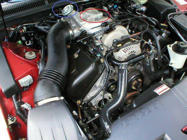

The IAC is the silver canister that sits right on top of your intake, it's right it front of your face.

The red circle is the IAC, the blue circle is the EGR.
Thanks KuztomKid you beat me to it..

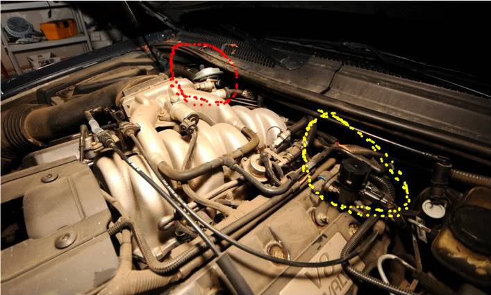

Now what is the Yellow in my picture? excuse the dirtyness of my car, havent cleaned since I moved last year.
Is it because of the IAC the part in yellow in my pic is not functioning/making humming noise?
How do I test IAC at this point to make sure it's the culprit?
The thing you circled in yellow is part of the PVC system.

the yellow part is the evap solenoid aint it? pcv is behind it.....
