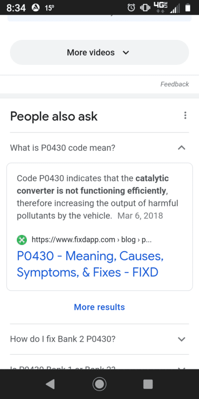

Well Joe is right about the P0430 code...
You have at least one defective catalytic converter. The aftermarket ones are known not to hold up bery long.
Some of the members on here have purchase the Magnaflow versions with good results.
Cheaper than OEM... but not as cheap as most aftermarket junk.

Well Joe is right about the P0430 code...View attachment 828576984
