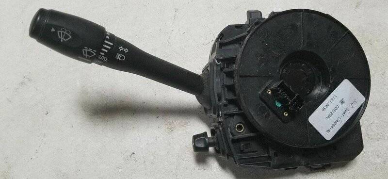

I managed to order a replacement used multifunction switch and the clock spring itself.
2003 04 05 2006 LINCOLN LS Clock Spring Turn Signal Switch 3W4T-13N064-AL | eBay so I am gonna change out the turn signal switch soon as that arrives and see if the fault comes right back but being it's a used part who knows if it don't have the same exact issue! New is just not an option anymore on a Gen 2. I have found new ones for a Gen 1 but no go on the Gen 2. Also after that explanation am I safe to assume the FEM or is it the instrument cluster that controls the multi-function switch?

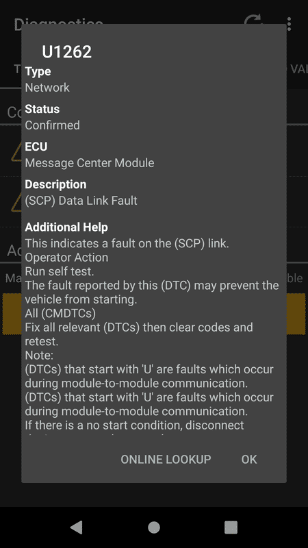

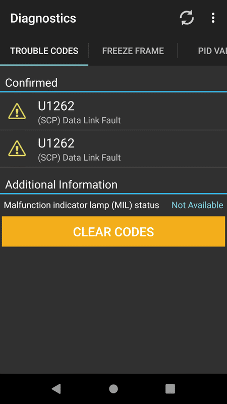

The code had went away for the turn signal switch but I went ahead and changed it out anyway just to see if there was any difference. However, I still see the u1262 in the same two places. I wanted to see if changing that turn signal would maybe atleast get rid of u1262. But that's now the only code I see I just see it in the ECU and Message Center according to forsan and OBDlink.
I can clear everything out and the u1262 seems to stay away till I power cycle the car. Does anyone have any ideas on the u1262 aspect of things? I even went ahead and changed out the headlight switch as well cause I saw a headlight code the other day but it also has not since came back. I figured since I had a brand new one of them I might as well try that as well. I doubt the headlight switch was the cause but I was actually planning to change it cause of the dome light knob moving too freely.
Both of my LSes had a U1262 pretty close to every time I scanned them. It would clear and stay away for at least a few minutes, so I never worried about it. I don't remember where, but I have seen it suggested that connecting a scan tool and/or running diagnostics can actually cause this error when there is no actual problem.
Oh ok, so I shouldn't worry about it unless the CEL comes on?

Does anyone know if the clockspring part that goes into the turn signal switch came with it when they are new? And what i mean by that if I worded that wrong is, does it come with everything pictured here?
So if I bought a new turn signal switch does it come with all that?
If so could the B1875 code be coming from the round part instead of the signal switch itself? I just found a brand new one from a Gen 1 that matches the same specs as my gen 2 but I am pretty sure the only difference is the clockspring itself. They didn't have pictures and I just placed the order cause they allow free returns if it does not work. However if it don't I will likely hang onto it for anyone that ever needs a new one if it won't work on my Gen 2.
No, to my knowledge the clockspring never came with the multi-function switch.
No, the clockspring has nothing to do with the signals from the multi-function switch.
I don't know, but it is very possible that the first gen multi-function switch used different resistance values than the 2nd gen one. I know that this is true for the cruise control and radio switch pods.
