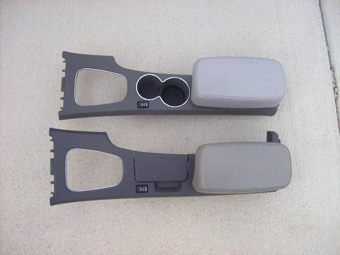

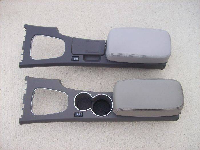

I think so. Here is a picture of the two next to each other. I did the 2002 center sole up-grade years ago. I did have to switch over the arm rest. The gen 1 and gen 2 as you can see were a different color. Easy direct swap.

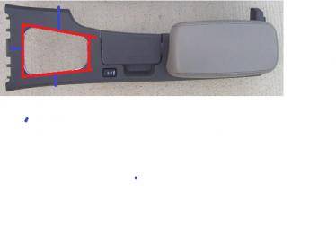

Any chance one of you fine fellows with an auto trans could get me measurments outlined in Red an Blue on this image?

Would you want the measurements for the gen 2? I can get you the gen 2. I would get you the gen 1 measurements. BUT I gave my old gen 1 console to a member that needed it.
Gen 2 measure ments:
The red measurements are 6 inches in length, 3 inches to 4 3/8 inches from narrow end to larger end.
The blue measurements are one inch frotn to ash tray, 1 inch rear to armrest, 1 inch to driverside, and 1 3/8 inch to passengerside.
Hope this helps. The gen 1 to gen 2 console swap is a direct swap. No changes are needed. So I can assume the measurements are the same for both consoles.

The '01-'02 is a direct swap into the '00. There will be a little gap (on my black interior pretty much unnoticeable) above the hand brake; as shown in Rollin's 3rd picture.

I get 1 1/4" front of opening to ashtray surround and 4 3/4" at the top, widest point (red). I also have 8" from the rear of the opening to the base of the armrest; where the top curves up. The rest of the measurements are the same.
