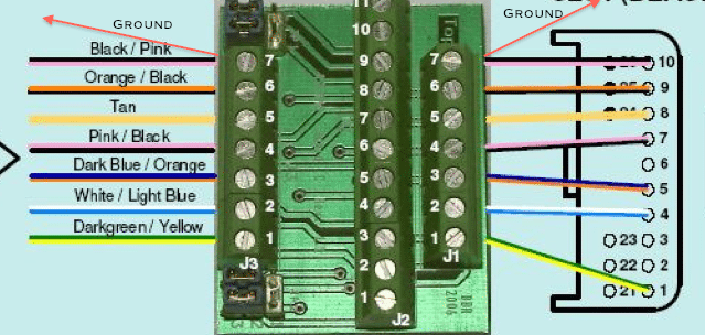

Well I finally figured it out. Turns out that board C the ground circuit is no good I ran separate grounds for everything and now it works. I'll clean the car up, put the 18's back on and get some pics.
How did you run separate grounds wouldn't you have to solder on the bords
There by voiding the warranty
All I did was add a extra ground wire to the corresponding ground wire using the provided schematic on page 5 of the instructions.
The arrows represent the wire I added.
For obvious reasons I don't have the "C" board to take pics of but when the replacement gets here I'll snap a shot of it before it gets sent back.
