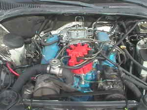

Here are a couple pics from the infamous Craigslist LS. A V6 car that had a '86 5.0 Mustang engine. Of course it's carbed which eliminated alot of the EFI mumbo-jumbo. The owner claimed it ran great and as far as the gauges only the fuel and speedo worked.
yep - that make sense - since he left the original dash in place - and the non-efi engine would not need a lot of inputs for a management system.
BTW - swapping and engine that is older is a no-no in states with an emissions check. The car must pass emissions with the same year engine or newer - and if newer, the eninge has to pass the emission rules of the newer year.
